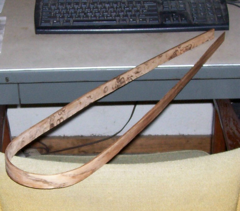

I saw you Peruvian Walnut on LMII today. Turns out it's not a true Walnut, so it may bend differently. Anyone with specific Peruvian experience?
My bet is hotter is better on this species. What's the temp reading on the thermometer?

im curious to see if there is anyone with experience working with peruvian walnut as well. good call bruce. it is, however, if i understand correctly, a true walnut. juglans neotropica. the wood i was having a problem with was the oak, however. my practice stuff, if you will. the temp reading on the thermometer never reached 300 degrees. i had the blanket on for quite some time. its still a bit of a mystery to me, but i have a feeling there will be a little more light shed when i give it another run.
Lillian, the blanket is a john hall jobber with the heat control (router speed control) and a digital thermometer he sends with the bunch. sides were bent blanket on top of slat/wood/slat.

Ahh, never reached 300.
I have a Minco heater runs around 800 Watts on 110Volts and will hit close to 500 degrees so they say. My thermometer only makes it to 400.
I use a 1000 Watt Commercial dimmer to cut back once everything is bent, just a switch and duplex outlet mounted on a board. Before using that control, I did like Jim Olson and used the plug and unplug method, it works too.
You might want to get a second thermometer in the kitchen gadget section at Walmart. John Mayes turned me on to it. About 12 bucks. This will give you confirmation that your thermometer is correctly indicating.

Here is a tutorial on bending. In a nut shell most peple tend to over cook or over wet the wood.
   If you are not done bending your wood to the pattern in 6-8 minutes you are waiting too long. I set the thermometer between the blanket and slats. Usually I am bending the lower bout in about 2-3 minutes at full power then then I do the upper bouts. The waist is done last so that the sides are "pulled" onto the bending pattern. Once I see the 200 degree mark I am checking the wood for relaxing.
    I never use softening products but if you feel you need them go ahead. The temp range for a good bend is 250-375. The staining can be either iron migration or water staining. I do see that once in a while on African mahogany. I think it may be something from the water chemicals or maybe even iron in the water.
    You have a good bit of spring back. This can be attributed to taking it out too soon or not heating it enough. I use 375 degrees for 3 minutes then 200 for a full 15 to dry out the excess water.
     Again check out the tutorial as you can get bneind instructions there or call me and I will be happy to help you. Never use the blanket without a controller . they will scorch wood.
   The full pattern you made will absorb a great deal of heat from your wood. That is why you see the patterns with the tubes. The heat isn't pulled off the wood and into the pattern. It becomes are large thermal mass.

"and the additional support from the form means that even thin slats perform well."
Uhmmm, the idea is that you need the support while the wood is bending but not yet in contact with the form (as occurs doing the waist and cutaway areas). So I don't see how having a solid form is going to make up for the lack of support from thin slats. Sorry.

things i will do differently next practice run:
1.  possible work indoors (if the wife smiles on it ) as the temperature is a bit warmer and the humidity probably lower.
2.  after the bend is complete, cook the side for twenty minutes or so at a lower temperature to dry things out.
3.  probably use foil and craft paper this time. i just realized that on the second side i bent (the worse of the two), i wrapped the side comletely in foil with no way for moisture to escape.
anything else?
as for bending with a hot pipe. i gave it some thought and then decided on the heating blanket. i figured i would probably end up using a blanket eventually anyway, so why not just start with it? maybe it would have been a good idea to get started with a pipe, but since im $200 deep on blanket/slats and hours in the shop making molds and forms, i think ill stick with my current method. thanks for the advice though.

     I believe there is more than 1 way to do this and you as the builder need to find your own path. I have been at this now for about 10 years and have learned a lot. Often because of a failure or I was lucky enough to get to meet some knowledgeable people like yourself.
     I know if you use the machine aluminum is not the way to go. Steel either stainless that is tempered or spring steel will have more than enough strength to support the wood.
    Warping on bending can be from a few things. Too much water , pulling out the side when it is still warm or sometimes it is the wood. That is why quality wood isn't always the cheapest but is often the better buy.

well, this is my third try. it seems like im getting worse with each attempt. not sure what to do now. guess ill try again, eh?
sweat the small stuff.
PostPosted: Mon Oct 22, 2007 4:46 pm
Posts: 783
First name: Kirby
If you were bending using a pipe I would be telling you wait for the wood to relax that you can feel it when it does.
Not having form bending experience limits my ability to help.
It does sort of look like you bent the waist first and cooked the bouts dry before you got to them. It is easy to be wrong just looking at a pic though.
I think you should describe the order of operation and a rough time line.
